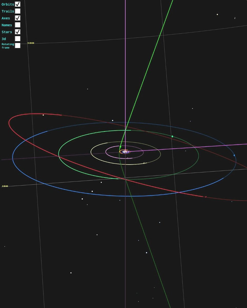

Tony Dunn Simulation:
https://twitter.com/tony873004/status/1171917219485192192

Das ist seine Bahn:
It seems much bigger than 'Oumuamua, so will also be much easier to study.
https://twitter.com/coreyspowell/status/1171706669732114432

Berechnete Bahn des Kometen C/2019 Q4 durch das innere Sonnensystem:
Credits: NASA/JPL-Caltech
