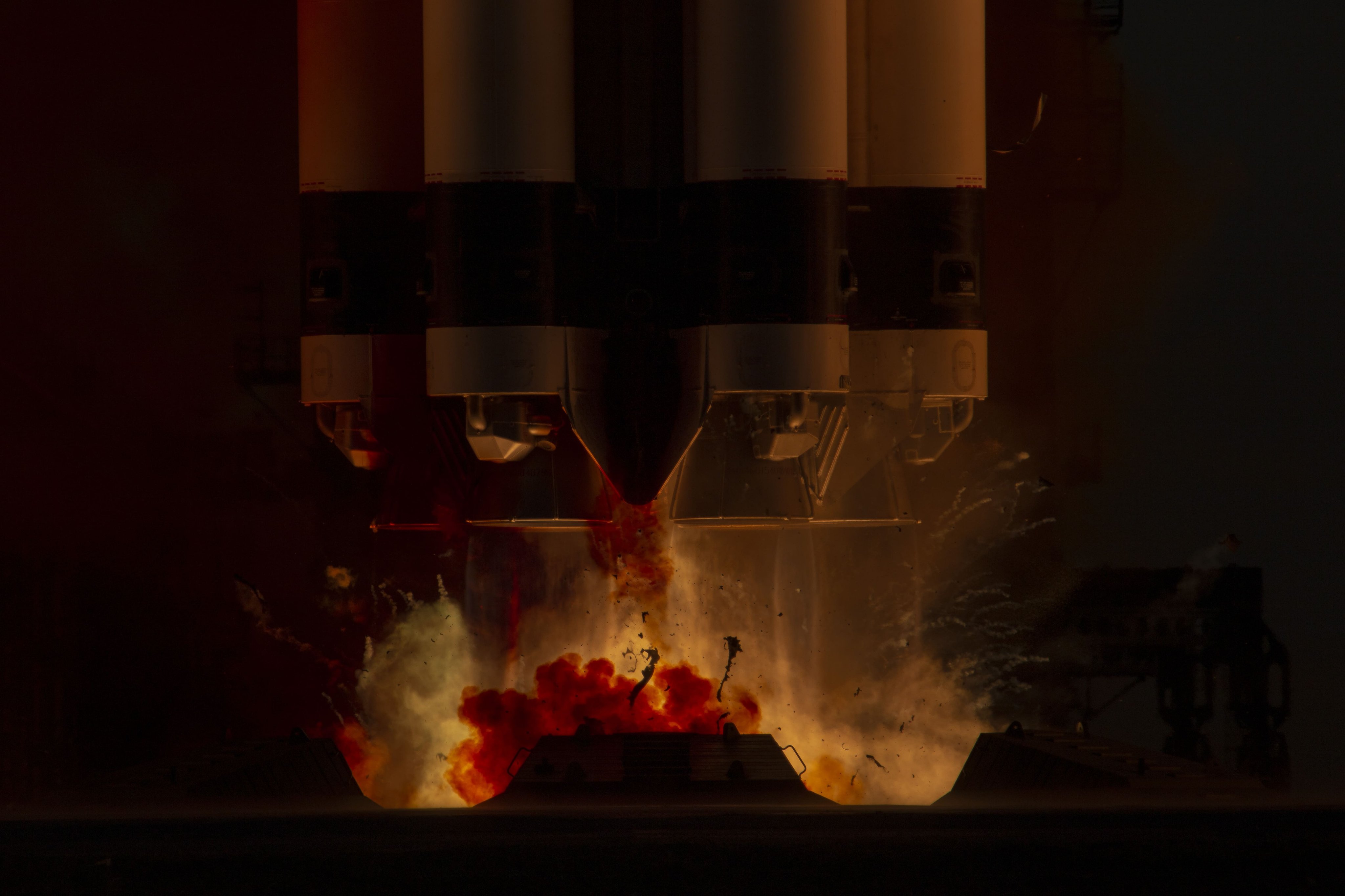

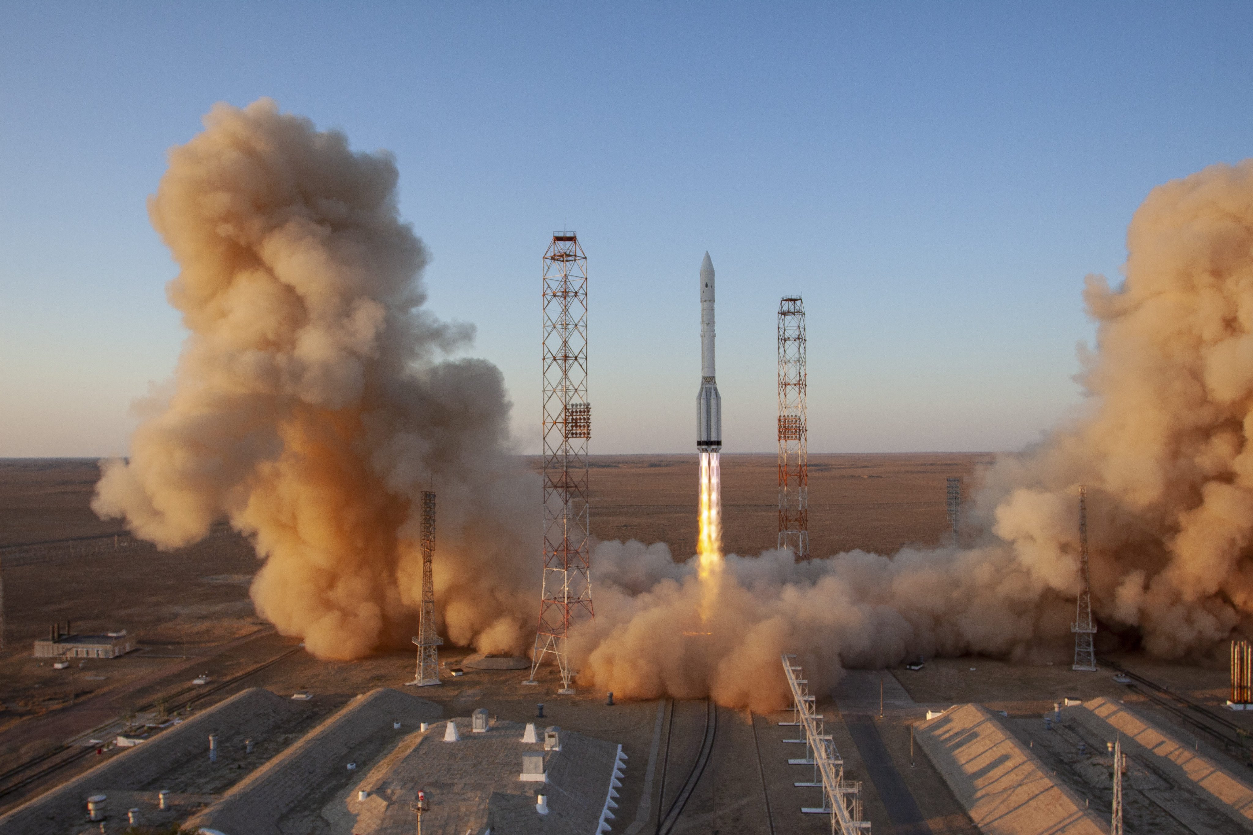

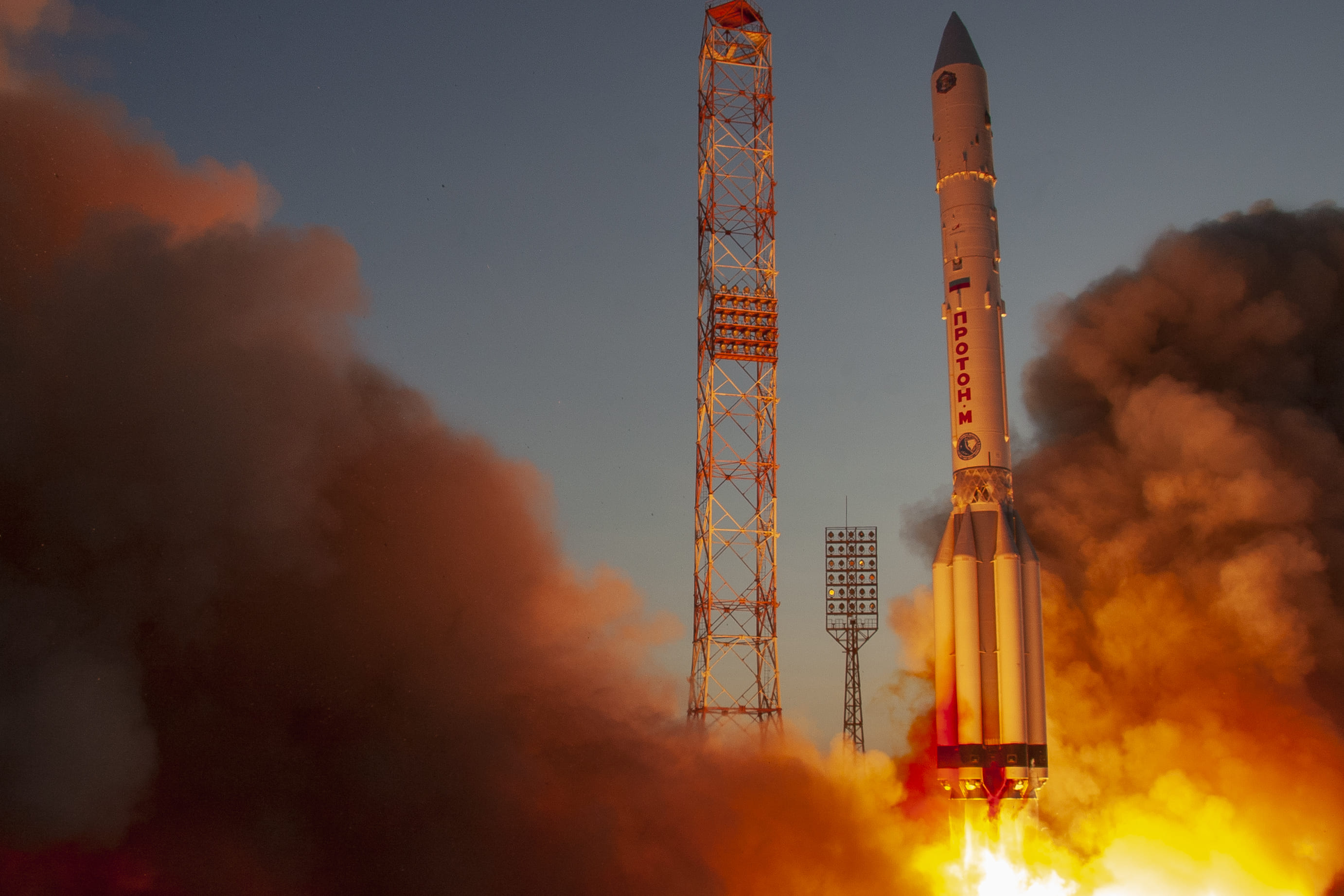

Fotos vom Start:  8)
https://twitter.com/roscosmos/status/1417937460554870793
