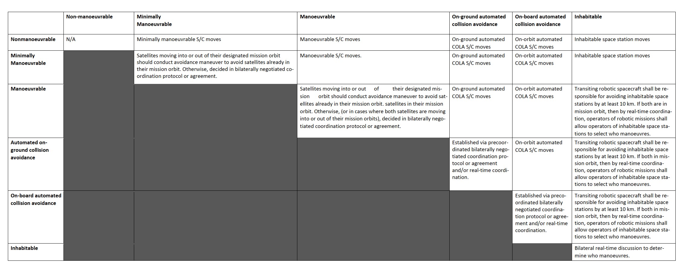

Ich kenne jetzt ein paar der Konzepte, wie STM konkret laufen soll ...
Es gibt den Vorschlag, Raumfahrzeuge in diese Kategorien einzuteilen:
  • Non-manoeuvrable; total inability to make flight safety-relevant orbital changes.
  • Minimally Manoeuvrable Robotic: Only able to perturb one’s orbit to a very small degree such that mitigation measures specified in ISO 23705 can be achieved but not within one orbital revolution.
  • Manoeuvrable Robotic: Able to easily alter the spacecraft course within one orbital revolution using available propellant to mitigate the threat of collision as specified in section ISO 23705.
  • Automated on-ground collision avoidance (COLA) manoeuvrable capability (robotic spacecraft performing manoeuvres based on on-ground automation (i.e. computation of the manoeuvre on-ground).
  • Automated on-board collision avoidance (COLA) manoeuvrable capability(robotic spacecraft).
  • Inhabitable (presumed manoeuvrable): An inhabitable space station that can alter its path to avoid collision
Für diese soll dann diese "Prioritätenmatrix" gelten, wer ausweicht, außer man hat eine andere bilaterale Abstimmung getroffen:
